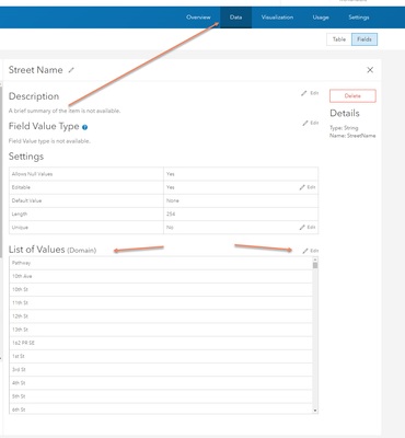

Making an attribute list for specific field is exactly what coded value domain is for, which can easily hold hundreds of choices.  Keep in mind, ESRI products tend to play differently with domains, sometimes it shows the Code, other times the Value, and often no consistency.  For years, I make coded value domains where the code is exactly the same as the Value.  That way, it is always "correct" depending on the viewer showing them.
As you probably know, you can add/modify the list in the hosted feature service:
But as you mentioned, you have hundreds of them, so would be pretty tedious to add them all.
But, since you should have the main list ahead of time, I would generate the table in Excel with two columns, one for code, the other description.  Then import that table to a stand alone table, and run the table to domain tool and assign the domain to the appropriate field.  This will add all the options so that when you publish/overwrite the hosted layer online, it will have these already.
