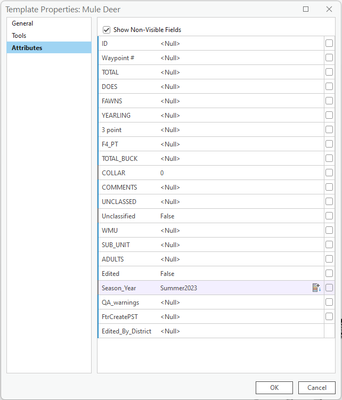

YES! With some help from ESRI Support we were able to figure it out. And once I did this workflow once I have not had to do it again. I work in Pro primarily but imagine a lot of the same windows exist in Desktop too.
Click Manage Templates under Edit Ribbon.
Select the feature and go to properties. Then in the properties window select attributes:
As you can see from my example the Default value is Collar with a 0 to indicate that the animal doesn't have a collar which applies to 99% of rows. What I had to do was just use that text field, enter in a space and then delete the space. Then overwrite the feature service on the server and double check that the default value is appearing in field maps.
No idea why it works like this, but it solved my specific problem! Let me know if you have any questions.
