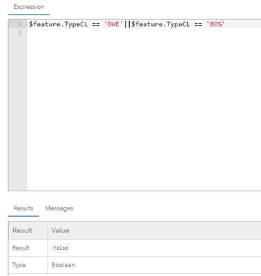

DirkPeterson2
That worked!  I also came up with this.  I'm new to Arcade, so is this correct too?
KenBuja
MVP Esteemed Contributor
That would work also, but as you add in more conditions, it can get unmanageable.
