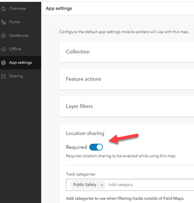

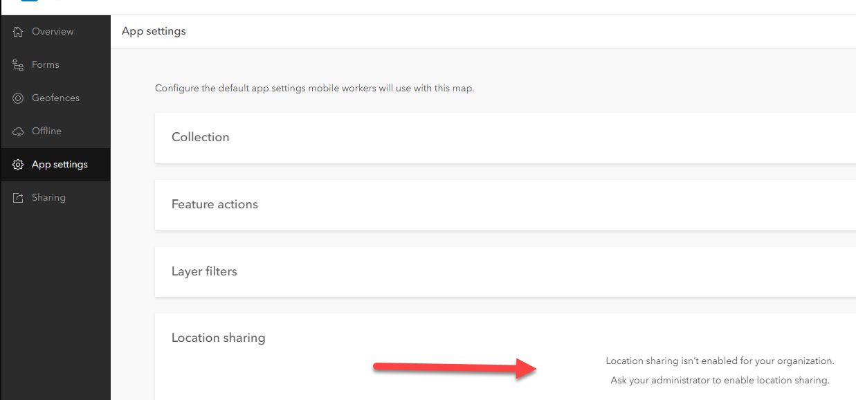

4. He has to go into the field maps designer and turn on location sharing in each individual app that needs tracking. (Are there different settings to choose from on this screen? Does this just add the tracking toggle to field maps, or does it require the toggle to be turned on for the users to be able to edit or save changes?)
5. In field maps designer can he select a checkbox to allow users to see each others tracks for the same field app. If he doesn't check this box then they will only see their own tracks. (Is this true, is this a setting in field maps designer?)

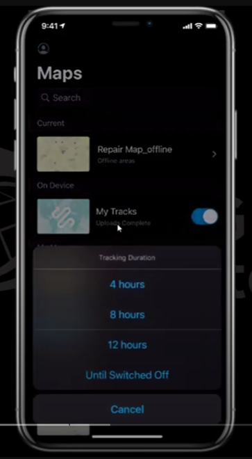

7. The toggle for location sharing is turned off by default in field maps and is not tracking the worker until the click the toggle. The worker has to select the toggle to turn on tracking, and select a tracking duration of 4,8,12 hours or until switched off. Even if they close the app on their device it will continue to track the worker until they click the toggle to turn off tracking on this screen or on the gps screen, or when the time expires.

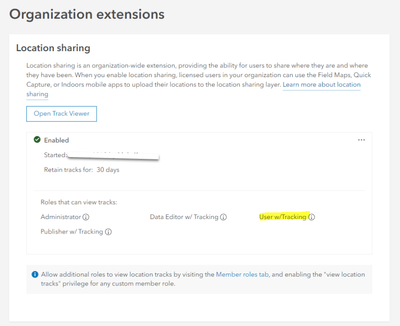

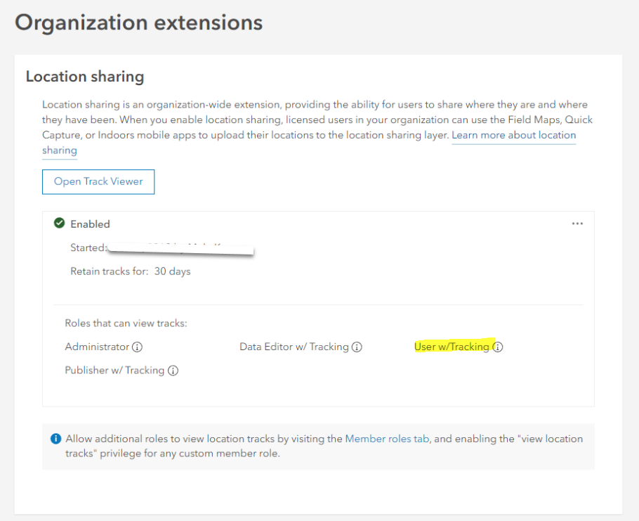

Correct, an admin needs to turn on location sharing for your organization and this does not turn on location sharing for any user. It just allows farther configuration to occur.
2. Configuration of what organization users can view track data is configured in TrackViewer where track views are created (https://doc.arcgis.com/en/arcgis-online/administer/create-track-views.htm). Only users with a role that has the view tracks privilege can view other user’s tracks.

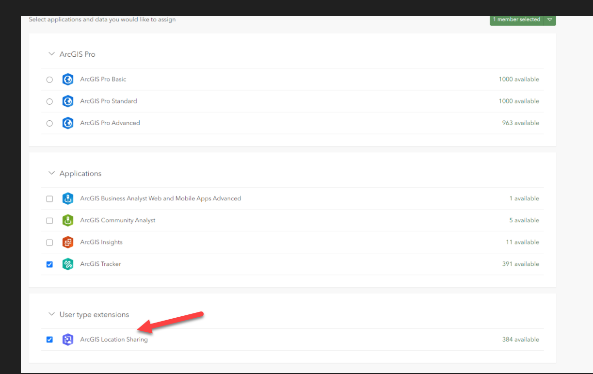

3. “Then he has to assign licenses to the users who want to use tracking.”
If the users are of type mobile worker they will be able to use location sharing, otherwise the user type extension will need to be assigned to each user that you want to be able to share their location.

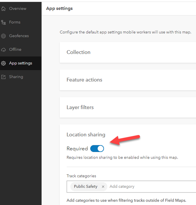

4. “He has to go into the field maps designer and turn on location sharing in each individual app that needs tracking.”
Configuration of an individual map to require location sharing be turned on (like you show in your screen shot) is an optional step.

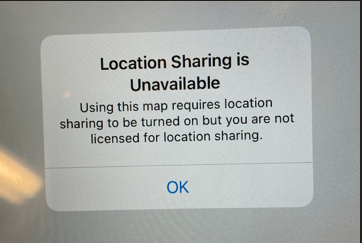

6. “Users who do not have the location sharing extension assigned to them will not be able to see the field app anymore if location sharing is turned on?” Users who do not have the location sharing extension will be able to use Field Maps without any issues, they just wont be able to share their location.
7. “The toggle for location sharing is turned off by default in field maps and is not tracking the worker until the click the toggle. The worker has to select the toggle to turn on tracking, and select a tracking duration of 4,8,12 hours or until switched off. Even if they close the app on their device it will continue to track the worker until they click the toggle to turn off tracking on this screen or on the gps screen, or when the time expires.” Correct, users need to turn on location sharing in the app and it will continue to share their location when the app is in the background

    Are you using using ArcGIS Online or Enterprise? From Enable location tracking:
    "If using ArcGIS Enterprise, configure the period of time you want to keep the tracks.
    By default, they are kept for 30 days.
    If using ArcGIS Online, tracks are kept for 30 days and the retention period can't be configured."

  3. "Can a TrackView map/app  be configured to only show tracks for a certain app/map."
    I think what you might be looking for is track categories.  A category can be set for a specific map so it is written to the track points when they are collected.  Then in the consuming map, you can filter for the specific category.
    Doc on how to set categories - Add track categories

Users of type Creator would need to have the location sharing user type extension assigned to them.  This is done per user, not by user type or role.  The Mobile Worker users type is an exception as location sharing is part of this by default (but does not apply to you if all field staff are Creators).  As you mention, you can leave the user types and role as is and just assign the location sharing user type extension to only the users you want to be able to share location, dont assign it to the others in the public works union.
