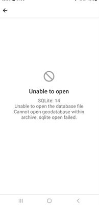

Hi learned friends,
Field Maps v 25.1.0 Build 1529 (I believe latest).  Android OS
I'm testing a Mobile Map Package .mmpk which is packaged in ArcGIS Pro and shared to ArcGIS Online.  Users would then download the .mmpk from Field maps onto their devices and work offline if needed.
I've done many of these .mmpks before without issue, for various geographic regions.

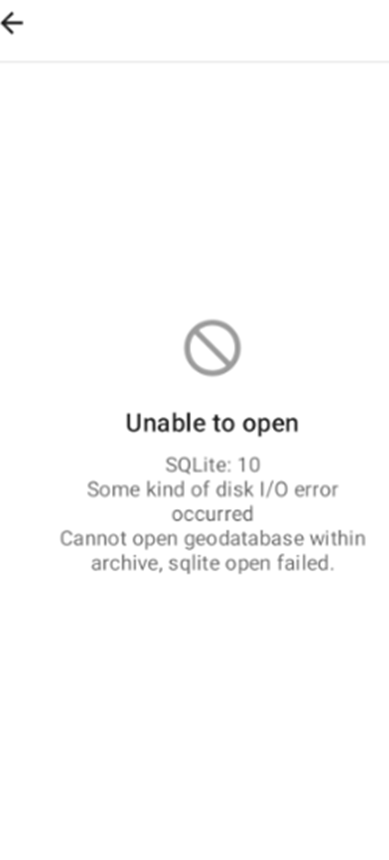

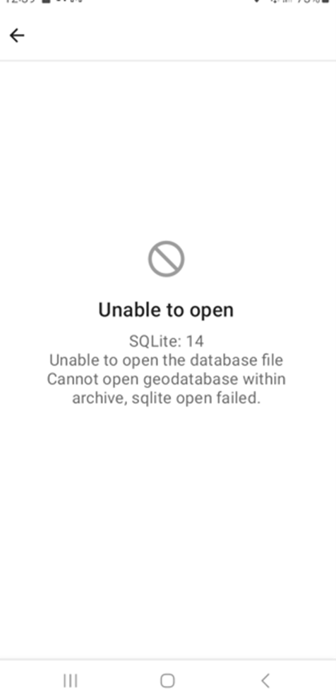

The .mmpk for this new region I'm testing is packaging and sharing to ArcGIS Online without error, but upon downloading and attempting to open in Field Maps I'm getting this error:
unable to open SQLite: 12 Unable to open the Geodatabase file within archive, sqlite open failed.
and another user trying it is getting a slightly different but similar error. (all attached)
From memory, this .mmpk is probably the largest I've created. (1.98 GB)  I've re-ran the process 3 times now and still the same error, also making sure to delete the previous .mmpk in AGOL rather than overwrite.
Because of the possible size issue, I then tested a 50/50 split of the geographic area, and it worked as expected.
I can't find much info on possible size limits and the .mmpk contains several geodatabases rather than just 1 big one.  However due to the error message I am leaning to some sort of .geodatabase size limitation.
The .mmpk also opens/works fine in ArcGIS Explorer Desktop and when imported into ArcGIS Pro.
.mmpk contents (approx):
.vtpk basemap - 954 MB
address points (.geodatabase) - 198 MB
.geodatabase1 - 405 MB
.geodatabase2 -345 MB
6 other .geodatabases - all total up to 30 MB
DavidPike_0-1743547688948.pngDavidPike_0-1743547688948.pngDavidPike_1-1743547724738.pngDavidPike_1-1743547724738.png
I've also raised a support ticket with Esri.  Thanks for your time.
Pierre-AndréBergeron
We are facing the same problem on Android and IOS since last FieldMap update.
The error we get is not the same finally.  The error we get is related to a Map access.
