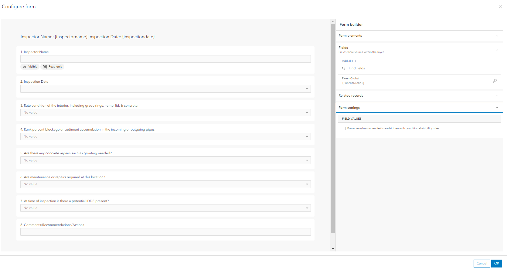

Hello,
I have been working on configuring Smart Forms for Asset Inspections in my Web Map. I was seeing if there was a way to save the form as a file. This way I can bring this way I can copy the file location into an existing script.
This is an example of one of my forms below:
 Thank you!

Hi Staci,
It is definitely possible.  We save all of our forms as JSON files and maintain them in using Version Control (GIT).  There is no button that will enable you to export to a file.  There are two ways that we go about it.
  1. Using ArcGIS Assistant we can access the JSON of a web map or layer, then we copy and paste into our file... in this case a JSON file.
  2. Using the Python API, you can access the map or layer definition and pull out the Form JSON and save it to a file.
Our standard workflow is to create a template form using Field Maps Designer, save the from to a JSON file in a code repository, then any time we publish a feature layer to AGO or AGE from a template we then use the ArcGIS Python API to apply that template Form.

StaciMcLaughlin
This is great, thank you! I was able to save the form to a JSON file using Visual Studio Code. I appreciate the quick responce too!
