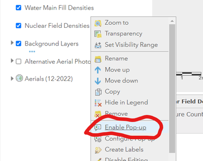

A couple things come to mind as possible solutions. First, a layer in the online map must be designated as an editable layer. If not, you can't edit the attributes, but this does not prevent the pop up box from displaying on selection in the mobile device or desktop browser. That is also controlled by the map creator, or other user with the proper role assignment to make changes to the online map. Once a map is published, sometimes the pop up boxes are not enabled by default and need to manually enabled.
This is done in the desktop browser by clicking the ellipsis to the right of the layer name where there are 'More Options'. If you have the right role assigned to your user name, you will see the option to either enable or remove  the pop up boxes, or to configure the pop ups. If you don't see those options, you may want to see your AGOL Administrator or the Map Creator.
If this already shows as enabled but the pop ups are still not showing on selection, you might try closing/opening the map, or logging out of ArcGIS online and back on, or even rebooting your devices.
Also, when a map is republished, some of the pop up settings that were manually configured can be lost and need redone. That has long been an issue but ESRI has made some improvements in that regard.

Open up the layer in map viewer, select the layer, and in Properties (for
layer, not map) there is an enable edit toggle. You will also need to
make sure that everything: the map, the layer, and any sharable items...
are all shared to who you want to be editing and the group the people
belong to if applicable (can't recall if a group is required or not). I
believe after you do this you will be able to configure more editing
options such as enable editor tracking. You may also have to enable sync,
at least if you are using maps in offline mode out in the field. Hope this
helps, at least point you in the right direction.

Thanks to both of you for the helpful responses. I checked to make sure the editing switch was turned on in the Map Viewer for all layers and it was, so that wasn't the problem. Then I enabled popups via Map Viewer Classic, just like the screenshot you shared. Then had to delete/redownload the Field Maps mobile app to clear the cache. And now it's fixed, I can tap on the assets and edit in the app!! Thanks again!
