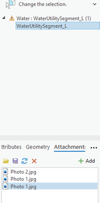

Field Maps is storing attachments with the same name. How is this prevented?

I am familiar with most of that. I still do not understand why FieldMaps would store 2 attachments with the same name on one feature.
I know both options of renaming photos. Renaming in the field is too time consuming of a process. We take 1000's of photos per site that we work on.
Renaming in post is what we currently do but when 2 photos have the same name, one of them will be overwritten.

I can't reproduce duplicate photo names in FM by default.  I can however produce duplicate names on the same feature by renaming the photos in FM.  We also rename post but we merge some fields together to ensure a unique name.  Something like {some_datetime_field}_{objectid}_{photoname}.  It would be nice if FM actively prevented duplicates on the same feature.
