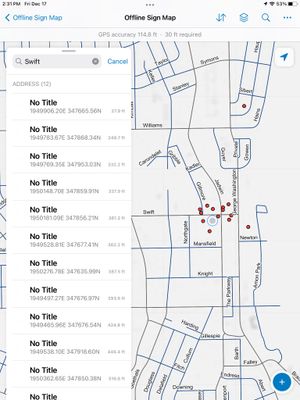

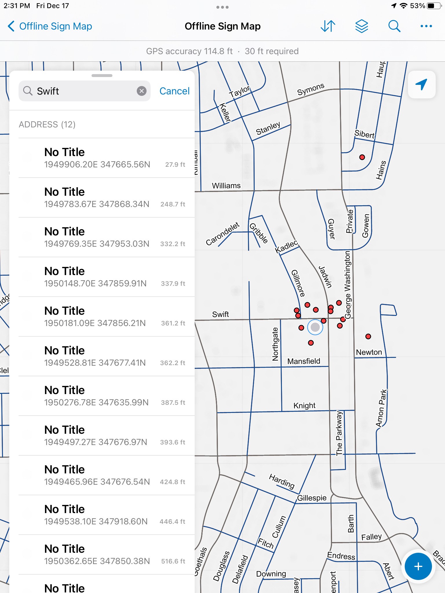

I have created a Web map for offline editing in Field Maps.  I included a point layer of addresses (with color=Null, and don't show in legend) just to have offline search capabilities.
Seems to be working, however, I do NOT want to have popups enabled for this layer.
If popups are enabled and I search for a street name (should be many addresses on that street), I get a list showing the results with the address as the popup title.
Click on the one you want, and it will take you to the location (as it should).
However, I do NOT want popups enabled, and without them, the search still works, but just repeats "No Title" for every result, which is essentially worthless.
Is there a way to show the actual search result title without also having popups enabled?

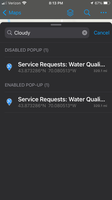

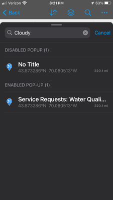

@RichlandGISI see what you mean. This is what I see for Android and iOS:
Map Viewer Classic Authored (Online)Map Viewer Authored (Online)Map Viewer Authored (Ad-hoc or Pre-planned Offline)
So yeah there's definitely something weird going on with the offline areas when the map is authored with the new Map Viewer. When the map is authored with Map Viewer Classic and the pop-up title is removed, there's no title to even show so that's expected based.
So I think there's two things there:
1. There's a bug when taking a map offline that the pop-up title isn't displayed. I'll log an internal issue for this.
2. There's a bug/enhancement to show something other than "No Title" (perhaps the displayField value for the layer or nothing at all). I'll log this internally too.

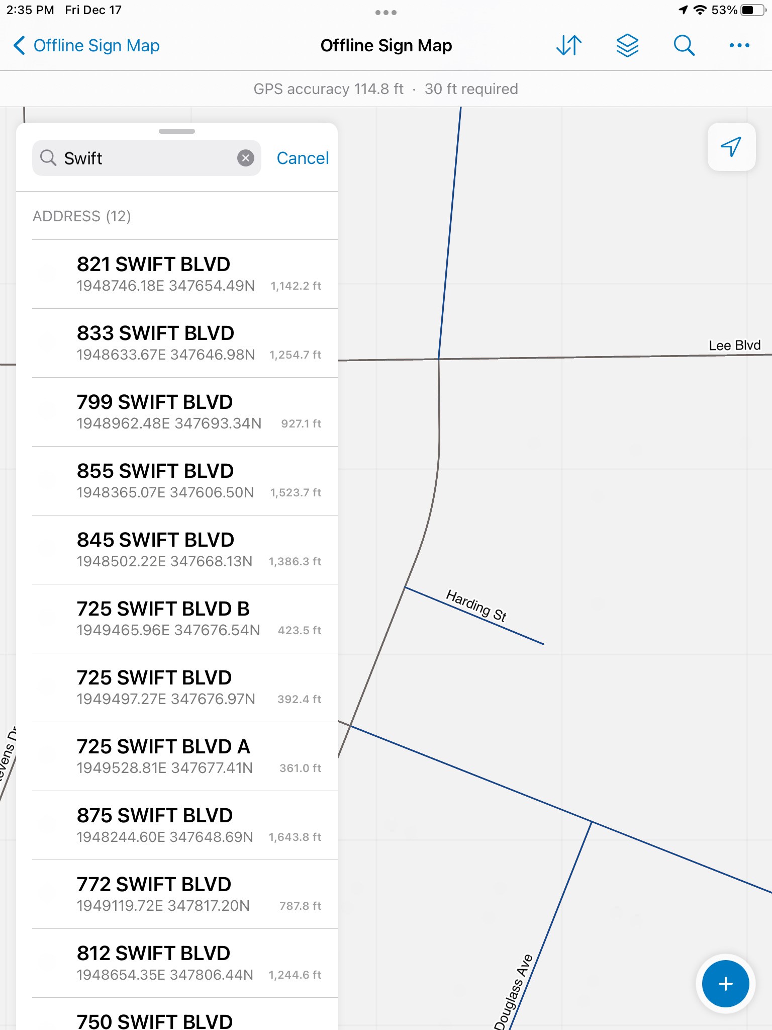

I have tested with both.
I "disable" the popup by turning off the popup slider in map viewer beta, or by selecting "Remove Popup" in classic viewer.  Also tried enabling, but only having a title field and no popup fields, but they still give me a popup.
I have to use Map Viewer Classic in order for Field Maps to even honor the popup settings/sorting in Field Maps, but doesn't seem to make a difference for this.
No matter which map viewer I use to configure it (beta or Classic) everything seems to work as expected UNTIL you take it offline.
Doesn't matter if I use Map details, or Field Maps to create offline area(s), or, if I have the client App download an offline area.  Once it is taken "offline", the popups no longer honor ANY of the settings.
