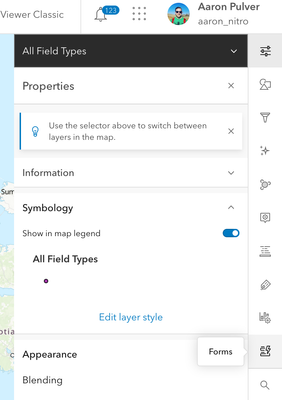

If you don't know if you are using forms you are probably not using them. You should probably start using them - you can convert the pop-up to a form with just a click of the button. I suspect the issue is that when the field is added to pop-up in Map Viewer the "editable" property is not set to true. This means it will not be available for editing in Field Maps iOS/Android. If you update the pop-up using Map Viewer Classic you can ensure the field is editable and visible in the pop-up.
I would highly recommend you use the Field Maps web app (https://arcgis.com/apps/fieldmaps) to convert the pop-up to a form. There are many more capabilities offered by forms. Forms are honored in Field Maps, Map Viewer, and other newer Esri web apps. You can also edit forms directly in Map Viewer using the forms action:
