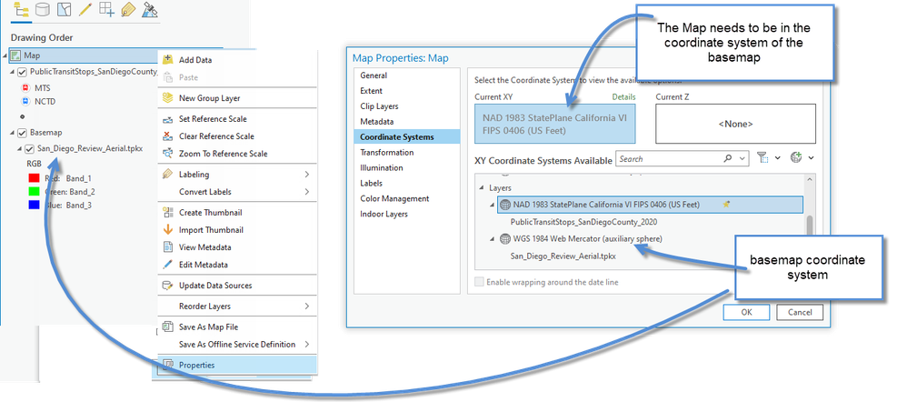

The basemap data needs to be in the same coordinate system of the map.   If you  are using .TPKX or .VTPK this is the reason.
Operational feature layers, the transit stops pictured above, do not need to be in the same coordinate system as the map to display.  The operational feature layers can 'project on the fly.'
Note: In ArcGIS Pro the map coordinate system is set to the coordinate system of the first operational layer that you add  to the map.   Also ArcGIS Pro can display all layers in any coordinate system, while Field Maps (The ArcGIS Runtime) cannot.  Specifically, raster date (imagery), TPKX and VTPK cannot be projected on the fly.  This data can only display in the coordinate system that it is in.  In the picture above the TPKX data is in WGS 1984 Web Mercator (auxillary sphere)  The map must be changed to this coordinate system for it to display in field maps. (or any ArcGIS Runtime App).
