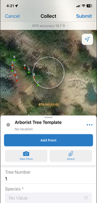

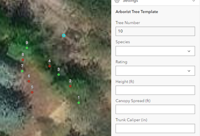

The script works great in the map viewer. If I add a new feature in the particular project I'm working in, it autonumbers the new feature 10 because there are already nine other features. However, if I open the same map in Field Maps and add a new feature, it autonumbers every new feature 1 regardless of the other tree numbers already in the project.
Map Viewer:
Field Maps mobile app:

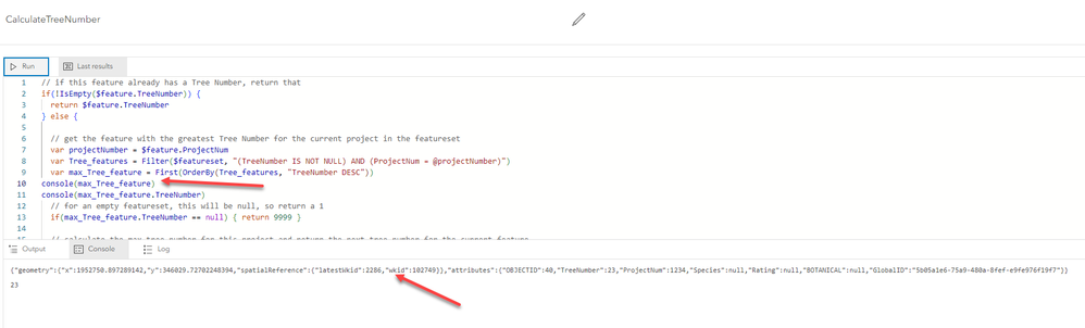

Turns out, that for some reason, you line 12 is evaluating to Null in Field Maps, so returns the value of 1.  Not sure why it works in Map Viewer, but, as you have seen, it does.
So, I added a console statement to return the max_Tree_feature and saw that it is returning a dictionary string:
So I tested by just extracting the TreeNumber value from the string to test for null (line 12) and it worked.
So, after all that, if I would have just said to replace line 12 with:
  if(max_Tree_feature.TreeNumber == null) { return 1 }
Then your original code works as expected in both map viewer and Field Maps.
