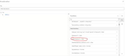

ThomasHusmann
When I manually typed in now() I had problems. When I went to the (fx) expression search and clicked on the option for now() it worked.
