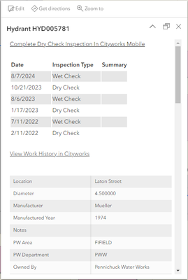

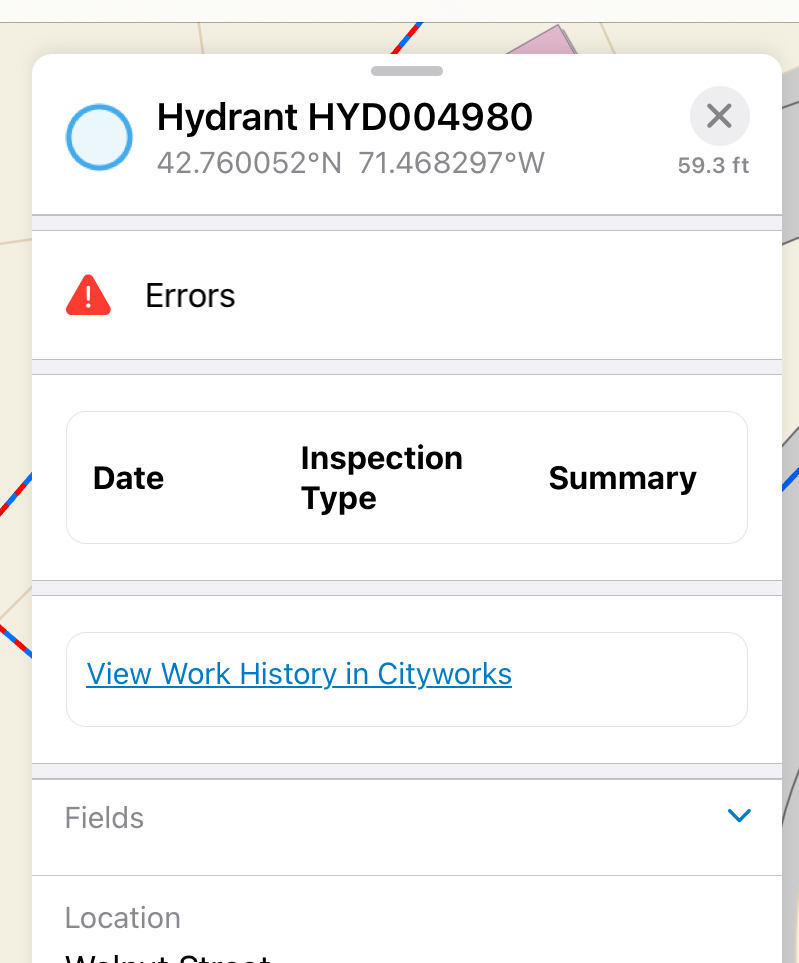

I'm working on an Arcade content block expression for a popup that will be viewed in Field Maps. The goals are to show a link to a CW inspection or work order that needs to be completed (if applicable), and to display a table summarizing previous work on that asset. It works great in the map viewer, but does not work in Field Maps. Interestingly, the link fails completely, but the table will draw only the header row. I've split those two functions into different content blocks so I'm only dealing with one issue at  a time. I've included screenshots and code snippets below. Anyone have an idea how to get that to work? I know I can get the hyperlink to work if I just pass it as a hyperlink in a text block, but that removes the "only show it if applicable" logic. The table is what really mystifies me, as the header displays just fine.

JCGuarneri

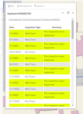

Some additional testing reveals that I can add a single dummy row in by using hard coded values, but only outside of the for loop. Inside the for loop, the rows are not getting added, but it works fine outside of the loop. So the following code results in this in map viewer:
and this in Field Maps:

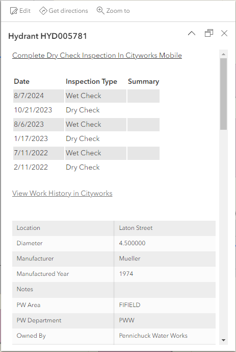

That's a good catch, and a symptom of copy/pasting code from another layer. Interestingly, it still seems to return the correct result whether or not I explicitly include the FeatureUid field:
I did try explicitly including it and it still errors out on the Field Maps side. I also tried hardcoding a URL to our company web site, and Field maps still doesn't like it. It looks like field maps has trouble with the <a> HTML tag, even though that's listed as supported HTML.
I also realized I pasted the wrong code in for the table portion. I've corrected that now if you are interested in that as well.
