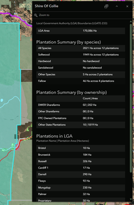

Below is an example popup in one of my maps that when clicking on an Local Government boundary searches (intersects) with a Plantation layer and returns values and statistics.

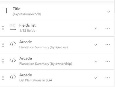

This is what you see in the popup designer:
and a sample of the arcade coding used in the Plantation species summary:
