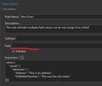

I'm unfamiliar with FIeld Maps. Do you implement the code as Attribute Rule on a feature class (that's what I'm assuming)?
Try creating a new Attribute Rule, leaving the field empty (forgot that in my first answer).

JD1016
No.  The code, or Calculated Expression, is being entered and applied within the ArcGIS Field Maps web app form itself (please see attached screen capture).  Once applied within that setting, you then go to your Field Maps app, reload your map, and attempt the scan in that environment.  The meter I am testing is actually in my office and once this returns the expected result can be implemented with our other meters.
