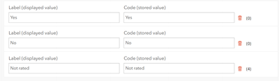

Since that field has Domains, are you using the same value for Label and the Code?
Ed_
by MVP Regular Contributor
Hi @KenBuja , thank you for pointing that out so yes the domain values and labels are the same as you can see below

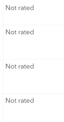

However, as if this moment they are no Yes values in the attribute it self, right now they are all Not rated
