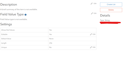

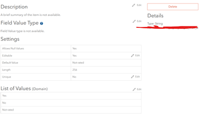

Ed_
by MVP Regular Contributor
This is the how Attribute1 actually looks like
and this is Attribute2
Question | Analyze | Visualize
