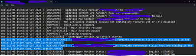

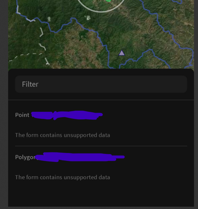

Adding new fields/questions in forms to Field Maps causing the offline maps to say "The form contains unsupported data" when trying to add new data.

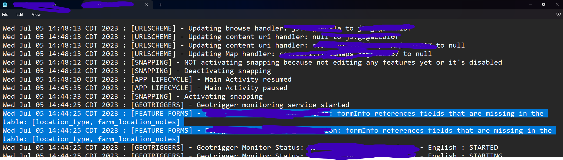

I added the fields last week and they were working fine for me and the team. But this week it stopped working. I checked the troubleshooting logs and it pointed me to my two most recently added fields.
When I delete those fields, the offline area maps work again. When I add them back in, it stops working again.
It works fine while using the online map in Field Maps, but my team will be offline. My app and the team's apps are updated to the newest version for Field Maps.
Since it was working for me last week and suddenly has stopped, and that I can fix the problem by deleting the newest added fields and recreate the problem by added new fields again makes me think that this is a bug. Perhaps there was a new app update this week?
