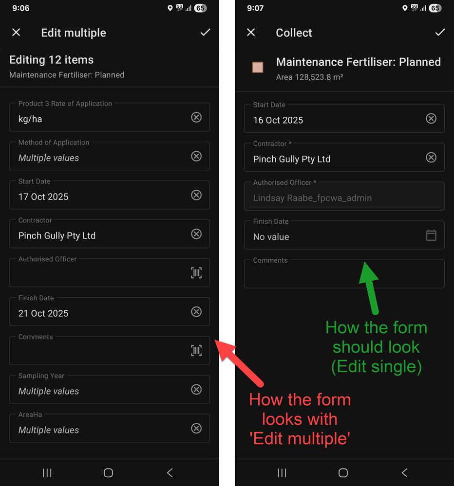

We are yet to implement any Edit Multiple functionality in our Field Maps due to it not honouring smart form functionality configured via Field Maps Designer.

I dont want to derail too much, but Edit Multiple now supports Smart Forms as of the 25.2 release of Field Maps.

@ColinLawrence thanks, but it's still not quite developed enough for our use cases. The below screenshot shows how Edit Multiple differs from Edit Single. In this case, the smart form, should hide fields that are not intended to be edited, whilst aren't strictly read only. Also, it should auto calc the Authorised Officer, but doesn't.
