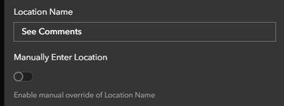

LindsayRaabe_FPCWA

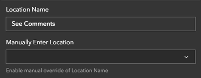

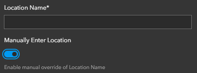

@AlixVezina Awesome! Works a treat. Copied my comment from the Blog post here.
Used it to enable manual override of a calculated location name based on intersecting features.
Calculated:
Entered Manually:

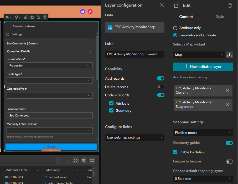

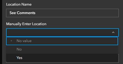

Found what looks like a small bug in Experience Builders Edit widget and Field Maps. In Experience Builder, the "Switch" option isn't loading by default until you click in the box and select a value from the list, then it changes to the switch in the "No" position (even if you selected Yes). See below screenshots. In Field Maps, it doesn't load as a Switch at all - just a drop down list. It also seems the default "No" value isn't being populated either.
Selecting "Yes" from List
Then changes to Switch in "No" position
Which can then be toggled to "Yes"

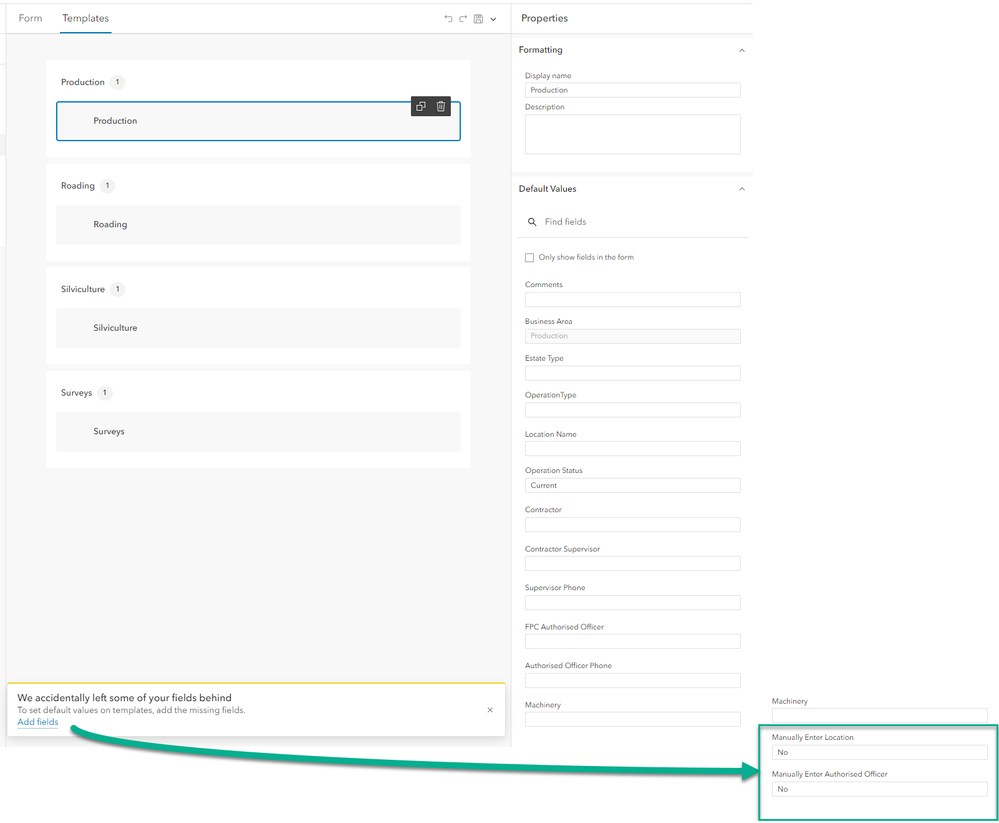

LindsayRaabe_FPCWA

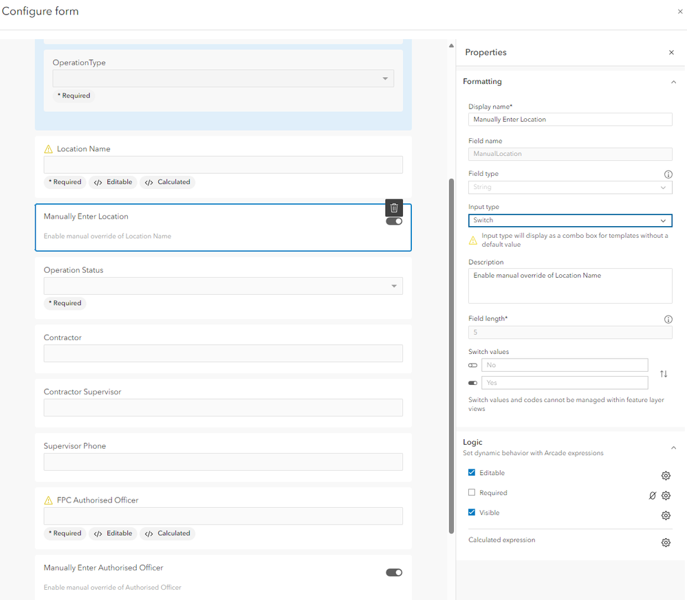

@AlixVezina Screenshots below show the smart form config in the webmap, again in Field Maps Designer and the Edit Widget config in Experience Builder.
I've noticed that there's a slight difference between the form config in the Webmap and Field Maps Designer though. FMD shows the default value property (greyed out) but webmap config doesn't. But that got me thinking, the other difference is FMD also has the Templates view (which the webmap doesn't) and when I looked in there as prompted by the little warning message below the default value section, I needed to update the template to include the new fields. Once I added those (and thus the default "No" values), it started working properly in Experience Builder and Field Maps! The only exceptions here are existing data that when edited, still don't have a value and it goes back to the "No value" combo box display (but I'll go through and update all features with "No" to get around that).
Lesson learnt - do smart form stuff in Field Maps Designer. 😑🌴
AlixVezina
@LindsayRaabe_FPCWA ,
Thank you for the details, and nicely done getting to the bottom of this one!
Yes, a default value needs to be set for the switch to display as expected. If the default value was not defined when the field was created, it is possible to do it from the Templates. Authoring and managing Templates is not yet supported from within the Map Viewer, but it is planned for an upcoming release. Once it's implemented, hopefully this workflow will be more straightforward.
LindsayRaabe_FPCWA
@AlixVezina I did set the default value to "No" when I created the field, but that didn't see to be honoured when creating features until after I updated the feature templates as well (which added the missing fields with the default "No" option).
