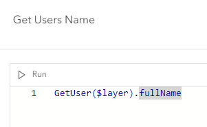

This capability would be hugely helpful for us too--for another related reason.
This past summer we had a big issue when we used the calculation "GetUser($layer).fullName" not realizing that this calculation doesn't work if the device is offline (a known limitation that we didn't know about).  Unfortunately, using a calculation makes the field un-editable and required. So when our users were collecting data and in a completely offline area, they were unable to complete/submit the form/data because the field was required and the calculation didn't work...and since it wasn't editable there was nothing they could do about it to move forward.
It seems like a small thing to have the users name calculated, but it helps with consistency and is convenient. Making the calculated fields editable would fix these grid lock situations when users are offline, while allowing for the convince when they do have service.

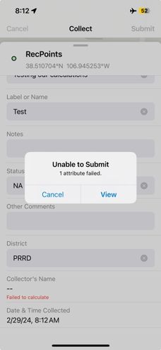

PamelaKing
@LindsayRaabe_FPCWA that is really interesting. I wonder if you have some different setting on your device or in your form that let it work--that would be awesome.  Even with it working for you, thanks for sharing that the editing would be helpful.  I agree!
I am so curious...have you all used the your form/calculation in  areas with no service at all?  That was when we were having issues.  For a while we thought it was just working, but we figured out what was happening was that people were in their offline maps but did have some level of service so the device was able to run calculation.
I just tried the calculation in a test map and put my device in airplane mode to simulate being completely offline and it failed. If you know of a setting that can make it work, please share with me.
