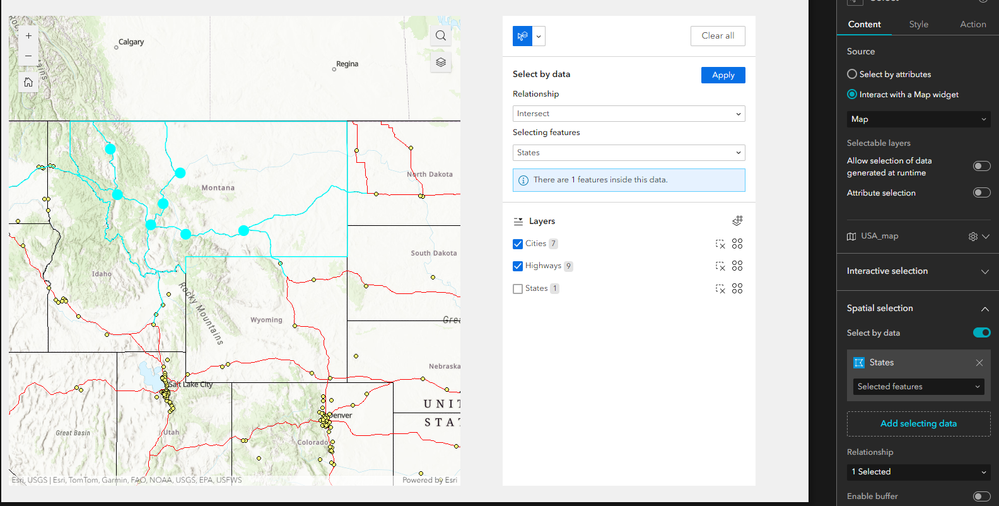

@K_Jueckstock Based on your description, I believe the new Select widget can achieve what you want.
For example, I want to select cities and highways based on a certain selected state, and you can configure the "Select by data" as a spatial configuration to do so:
