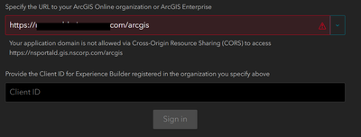

Getting:
started client and server on local. and browing to https://fqdn.com:3001.
i have added the https://fqdn.com:3001 without the trailing backslash to the portal's allowed origins list.
is there an additional step needed?

https://developers.arcgis.com/experience-builder/guide/install-guide/
As per step 7 of the Installation Guide, your Redirect URL requires https://localhost:3001/
localhost is what your computer calls itself. When building a project in Experience Builder, your computer will be functioning as a server to itself.
