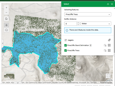

We don't have the spatial filter yet. But besides the Query widget, now you can try the "Select" widget introduced in AGOL 2024 Feb. release which allows the spatial selection and its "Record selection change" message could trigger the framework's data filtering action.
JustinH
@DanJiang Dan can you provide a workflow somewhere for this? I have been trying to use select as a spatial filter but it does not work for me. When using "Select by Data" it always says there are "0 records to select"
I have tried multiple ways, even pre selecting the polygon to filter points within.
Ke_Xu
by Esri Regular Contributor
Hi @JustinH,
For your case, please use polygon layer as selecting data.
Thanks,
Ke
JustinH
ayee! Thanks so much. This has been driving me crazy. I think it is somewhat confusing as to why I wouldn't add the point data. I guess it has the same syntax as select by location tool. I appreciate your help!

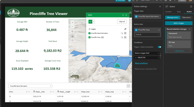

@Ke_Xu  I am noticing that I am unable to filter the framework because the trigger data has no direct connection to the action data. I seem to have no problem selecting and filtering the 3D map which is awesome but we are hoping the data can be filtered so we can get stats on each stand. I will set a random trigger field and then it automatically removes it when I close out. I am trying to filter the data so it can trigger my dynamic text. Do you have any solution for this?
JustinH
So many comments from me- I figured it out. I had to enable "Customize Layers" In the select tool contents pane. This enabled me to allow for customizable trigger actions. Hope this is helpful to someone down the line!
