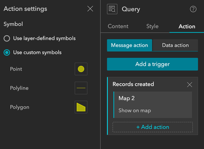

I tried to achieve similar functionality with Query widget, which can spatially filter the features and show them among the query results, but not on the map. I configured the Query widget with actions (like below), but in this case it will always be just 1 feature (the selected one) that is displayed on the map.

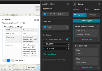

Your solution with the Query widget is in the right direction. To ensure the query results show on the map, please configure the following message-action in the Query widget.
Query - Action - Message action - Records created (trigger) - Map (the target widget) - Show on map (the action)

I am afraid using the Query widget is the only way to apply spatial filters in ExB for now. The popup will be displayed on the query result panel. For other data related connection, you can configure a "Record selection changes" message, to make sure the corresponding record in the original data source be selected when you select the query result records.

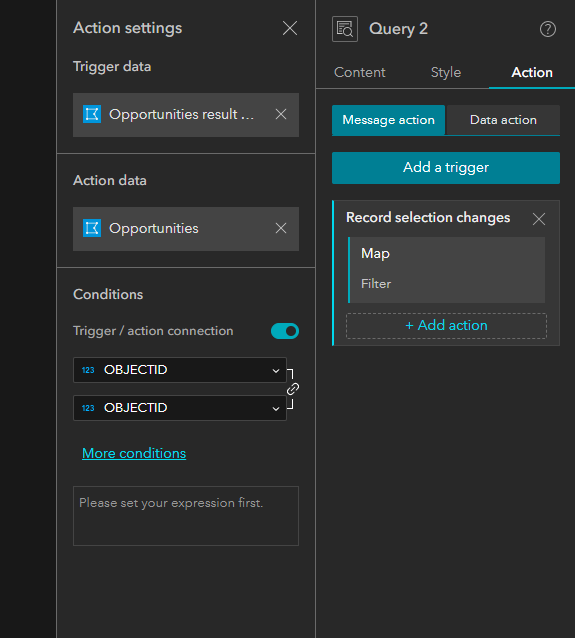

As an interim, since the ability to have the same spatial filter on EB as you do on dashboards would be very effective, is to extract the OBJECT ID of the underlying polygon to the point features so that you are able to setup a query action from the map
