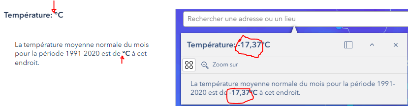

The "Feature Info" widget have some bugs when interacting with an imagery layer coming from a webmap.
1. It does not display the Service Pixel values despite it showing properly in the context window of the map:

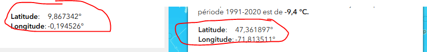

Another error with the widget: the arcade "$userinput" variable seems to have different coordinates between the map pop-up and the Feature info widget informations:
It the Feature Info widget coordinates don't change when i click anywhere on the imagery layer. I suspect that's why the Service pixel values are not written properly
