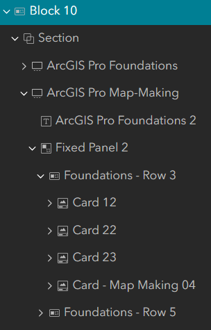

Thank you for your help, @NicoleJohnson! I will try this. How did you get the rest of the elements nested in a "Block" section? There isn't a widget for "Block", but I did notice that in my layout, because I have a Section and Views Navigation widget, the "Block" outer nest is created automatically. I'm just not sure how to use "Block" to replace my "Fixed Panel" - screenshot attached below.
NicoleJohnson
MVP
@Tiff, blocks appear automatically as you drag widgets onto the canvas, or there are some block templates you can use (these are accessible via an icon at the bottom of your page). They're not the one key to a solution here, I was just describing the setup for a similar-looking kind of layout that works. From your screenshot, now I can see that you're housing everything in a section, which totally makes a difference, and I'm not sure how to make that aspect of it work.
