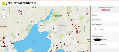

Im setting up a projects mapping tool using ArcGIS Experience Builder.
The purpose of it is to log project locations on a map.
Im using Feature Layer hosted online with a group of ArcGIS users who enters projects to the map with associated attributes.
Im trying to eliminate users to use duplicate project numbers unintentionally. A project number is a sequential number so if someone entered x for the project number, I would like the next project to be entered x+1.
From what I read there is no way to repopulate the default value for the record on ArcGIS Online.
So I added a dynamic text field suggesting the next Project number based on the max value in the field plus one.
Question: is there a way to get a warning to the user if entered project # exists to confirm it before saving?
