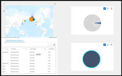

1. Filter with the first chart (Life Stage == "Juvenile")
2. Filter with the second chart combined with the first one. Both map and table responds as expected

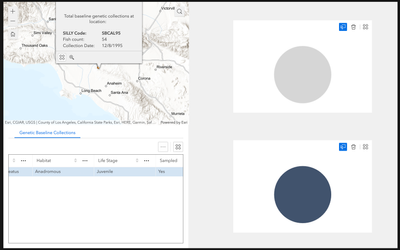

3. Select records on the map, the table got filtered:
