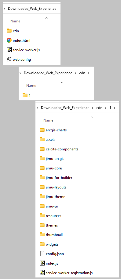

I want to use an ArcGIS Online Web Experience in an environment where there is no internet connection. I installed the ArcGIS Experience Builder Developer Edition, created a new application, ran the server through node.js, specified the URL to my ArcGIS Online and added the Client ID given in the application. After those steps, I imported the Web Experience page from my ArcGIS Online account and downloaded it to my local disc. The content of the downloaded file is below:

Hi @MelanieVT , I am afraid that ExB does not support embedded data. You can use the Add data widget to upload data files at runtime, but the operations are limited.

MelanieVT
Thank you very much for the clarification, @DanJiang🙏🏽
