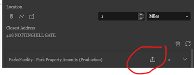

I'm creating an Experience Builder app including the Near Me widget. I would like to be able to use the list of returned results in other apps (not other widgets on the same ExB app - other apps entirely). Is there any way to do this? Is there a way to save the returned Near Me results, or create a list of the results to be used in a URL with parameters that can then be used elsewhere?
This is using standard Experience Builder by the way, not developer edition. I don't have any Javascript experience.

Near Me has the Export Data Action.
This will give the user a csv of their Near Me results.
This csv could then be potentially be uploaded to a different application.
