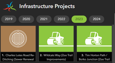

Ah if it's supposed to be something different that's fair, just quickly then, in my case I am looking to show infrastructure projects based on the year started, designed to replace the Shortlist Storymap template.
I have a layer view created to not include unapproved projects (year set as 0) or in the future I will do the same for older projects once this app has been around longer and they're not as relevant to the public.
I have a default option on the filter (2023) and only want the user to be able to pick by year, no need for an all option, and have it filter the list widget and the map widget. The pills are more user friendly than the drop down I find. The filter was just the cleanest way I found to do this.

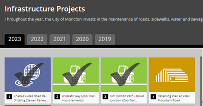

Ah, thanks for posting this example, this makes a lot of sense. In your case the radio list is correct because you do have a default value and you toggle between options to filter the same dataset. Actually the previous version with tabs used the wrong UI element (tabs are supposed to navigate between different sections of a site, not to filter). I like your visual design too, look really nice, dark themes are difficult but you came up with a nice palette.

@MichaelGaigg No problem, sometimes the easiest is just to show what we're looking at trying to do! And thank you I'm glad you like it! I can share the whole thing with you too if you'd be interested in seeing before it goes live.
Okay so radio button list is the right thing to do, is this possible to do in Experience Builder? Or is the filter widget as I have it set up the best way to do it right now?
The previous version is a direct Esri Classic Story Map template that has been deprecated, hence the need to rebuild it. I'd definitely be interested in talking about the challenges I've been facing in rebuilding this classic Esri favourite!

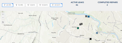

@RobertAnderson3  and @MichaelGaigg I'm after exclusive radio buttons (or pill buttons) also. Here's my use case:
  • Dataset has data covering last 30 days
  • I want filtering options covering: 24hrs, 72hrs, 5 days, 10 days, 30 days
  • I can easily do this via Filter widget but the user is able to select multiple filters and that leads to a frustrating user experience.
