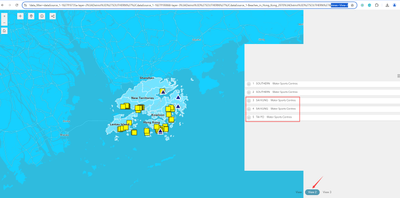

Ke_Xu
by Esri Regular Contributor
After clicking on the Views, then refreshing, issue could be reproduced. I will let you know once issue is fixed.
