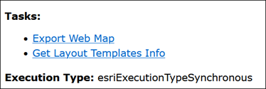

can you pls check if you have Get Layout Templates Info task in your print service? They service directory of the print service should look like this:
TanuHoque
@adriancmlee
adriancmlee
Yes it works, thanks!
