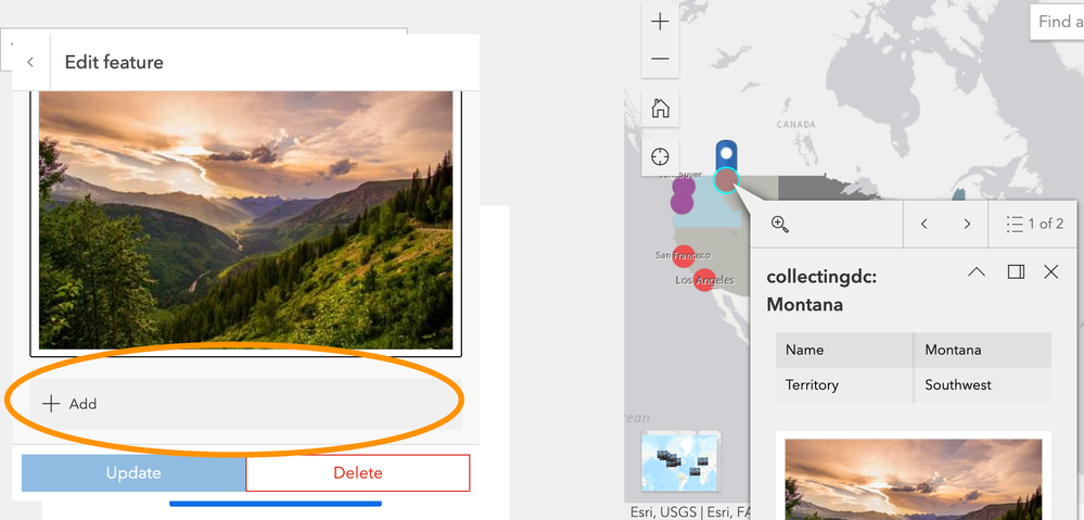

Hi @mtebbe, I tried one layer of my own, it can allow upload attachments as follows:

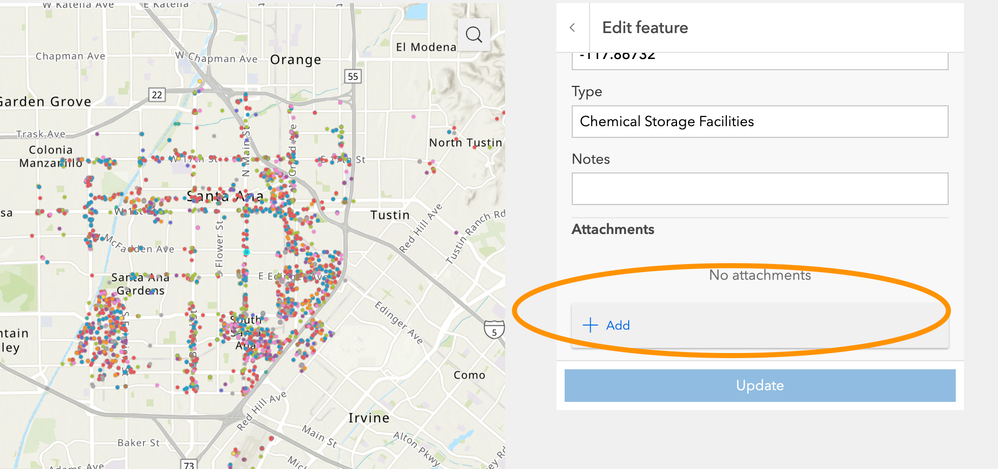

I cannot access your ExB app, but using your shared layer, I can get it to work as expected in ExB - select a feature, choose from the adjacent list for a specific one, and then you can upload attachments:
