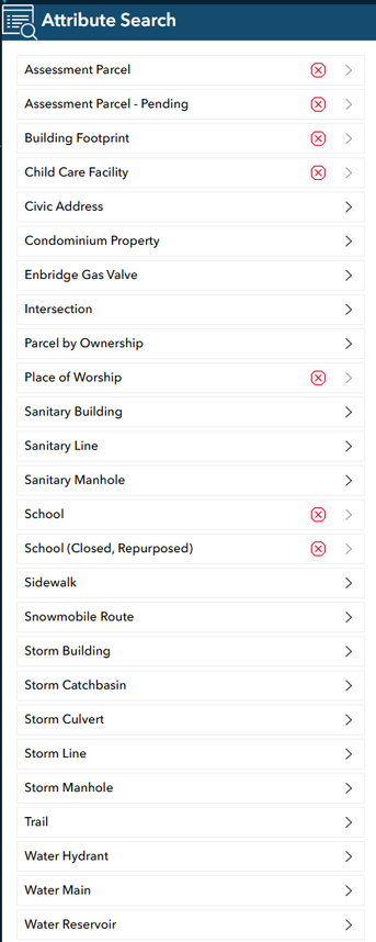

Spent a day and a bit configuring a Query Widget in an Experience Builder my team is creating for our end users. Got everything in the Query Widget working fine and come in the following Monday morning after the weekend and load up the Experience Builder in view mode to find that a few (3-5) layers are throwing errors in the Query Widget and say "Data is inaccessible". I turn on visibility for those layers in the map and they seem to work fine (symbology, labelling, pop-ups all working). So I refresh the Experience Builder view and those layers are fixed now, but now 3-5 other random layers show the same issue as the previous ones did. After refreshing several times the same thing would happen (previous layers worked fine again in the widget but a new set of layers said data was inaccessible and showed a big red 'X'). Then all of a sudden one refresh everything was working fine again and subsequent refreshes showed no errors.

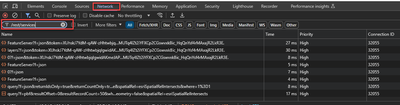

@CameronLacelle when you are viewing the exp application, are there any errors reported in the Network tab of the web browser's Develop Tools (ctrl+shift+I is a shortcut to open this) for the services?  You can filter the rest services by searching for /rest/services:
CameronLacelle
No errors reported, just did a couple refreshes to see if anything came up. Right now the Query widget isn't showing any of those errors from before (but I am sure they will show up again). I will try to catch them in the dev tools logs when they occur next.

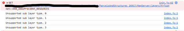

I did however see some errors pop up in the console. Seems these are related to a particular layer which is odd, I'll have to investigate because I've not seen any errors or warnings (aside from big integer fields or coordinate system warnings when sharing from Pro). See below:

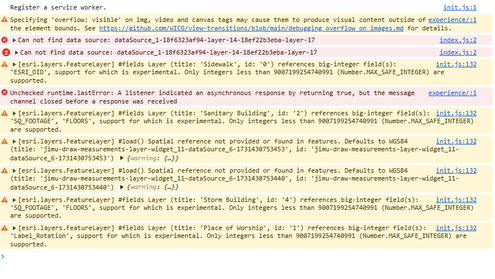

@JakeSkinner Saw this error this morning in dev tools and those layers had the same issue in the query widget that this original post was for, and the layers would not draw. But when I refresh the page again it's fixed.

The error message "net::ERR_INSUFFICIENT_RESOURCES" in the context of Experience Builder applications typically indicates that the browser is facing resource limitations while trying to load or run the application. This error can occur due to various reasons, such as:
  1. Memory Usage: The browser may be running out of memory to handle the resources required by the Experience Builder application.
  2. Too Many Open Connections: The browser may have reached the limit on the number of open connections needed to load the application components.
  3. Large Application Size: Experience Builder applications with a large number of widgets, complex layouts, or heavy media content can strain browser resources.
  4. Network Issues: Problems with the network connection or server-side issues can also contribute to this error.
