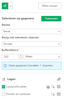

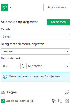

Dear developers,
The (powerful) select widget supports buffer selection based on data. However the widget does not give equal results between kilometers and meters (the ones I checked based on my users needs). It seems that the kilometer setting does it correct. I provided screenshots as proof for this bug.
Screenshot 1: 0.2 kilometer buffer yields the correct amount of 4 results
Screenshot 2: 200 meter buffer yields the false amount of 0 results

Hi ECJRIJS,
I could reproduce this issue. I will let you know as soon as it is fixed.

Hi @ECJRIJS,
This issue(BUG-000166931) has been fixed on November 2024 version.
