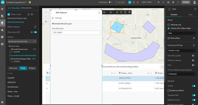

Hi @Service_SIG_CAPDFT
Have you tried the Edit widget's map mode? It supports editing related records.
Gene_Sipes
What is this map mode? How do you enable that?

Allen_Zhang
EvanManrow
This doesn't work for many-to-many related tables. There isn't any way to add them to the Edit Form. Neither Map Viewer nor Field Maps allows it.
I say this somewhat over-confidently, in the hopes that someone will correct me with a working solution — but after spending this week fighting the issue, I'm pretty confident it's impossible. 😕
Allen_Zhang
It's true.

EvanManrow
Using a hosted feature service (via "Publish Web Layer" in Pro) gets one step closer: it will at least show the many-to-many records reliably in Popups. That doesn't really make sense to me, since I have to add the Service to a Web Map to load it into EB anyway.
But without a way to add the Relationship to a Smart Form on the feature layer, there is no way to edit the relationships in AGOL. From the intermediate Table I can delete records, and from the Related Table I can add new features to the related Feature Layer, but I can't associate existing Features and Records.
