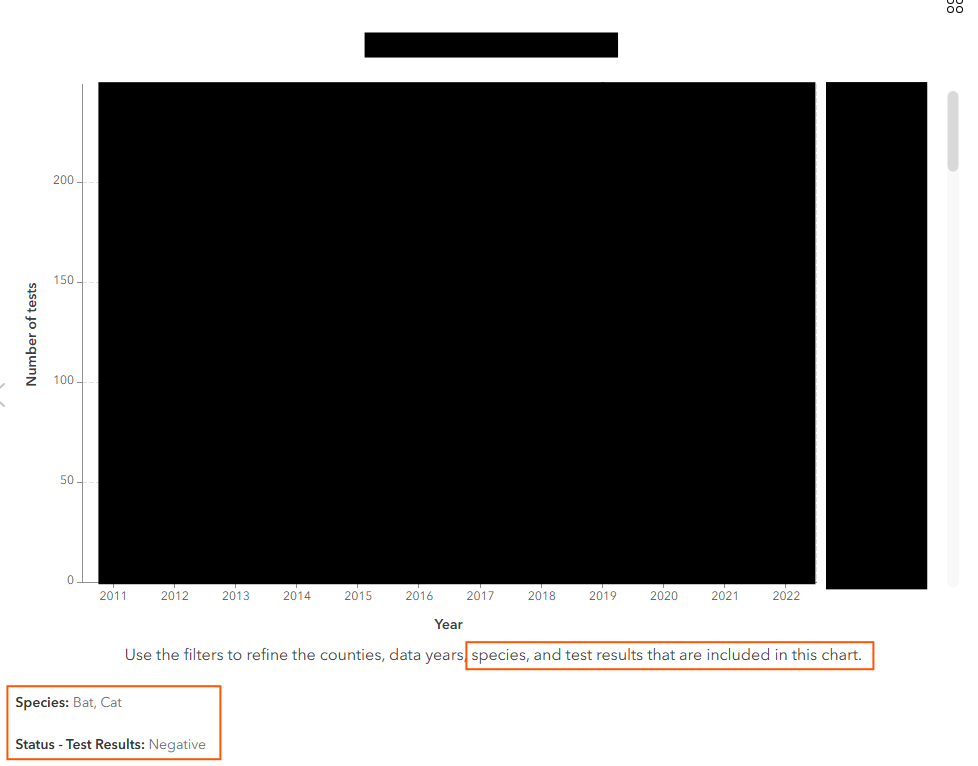

For example, here's a chart that displays the sum of tests by year, categorized by county. The user can filter this chart by county, year, species, and/or test result. The first two variables are already covered in the chart itself, but the species and test result values are not. With the new Arcade capabilities in Experience Builder, I can just print out the species and test result values (filtered by the user) that are contributing to the chart:
However, I'm finding myself already hitting the limit in terms of number of expressions that use $dataSources per page.

1 – When the page loads, all Arcade expressions on that page are evaluated at once, which can use a lot of resources. This limitation is in place to help maintain performance and avoid potential bugs.
2 – It’s a bit tricky to remove this limitation, a workaround is to use HTML format and keep just one Arcade expression per text widget. That should help reduce the overall number.
3 – That last one is a bug and will be fixed in the next release.

I'm already using one expression per text widget (i.e., the species and test result values are coming from one expression, with HTML formatting). I just have like 11 or 12 charts on this page, so either have to decide if I want to scrap them entirely or only do some of them...
