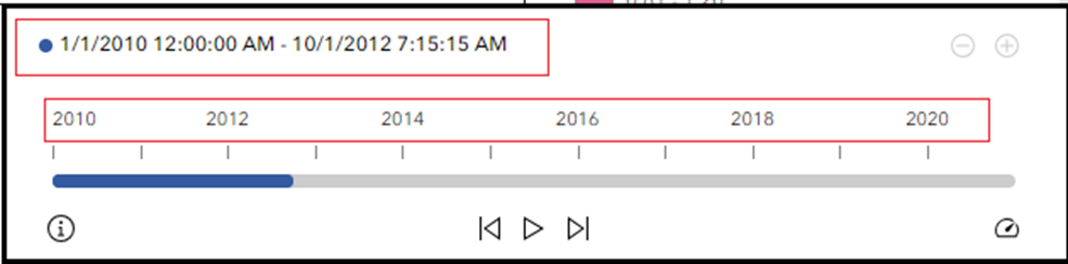

Would anyone know if it is possible to edit the timeline to only show the years corresponding to the years in the data? My layer has only 4 unique times (2010, 2013, 2016 and 2020), so I would like to show just the correspondent years in the Timeline. As you can see in the print below, there are other years appearing. I am working on the Experience Builder app.
Additionally, I would like to remove the date and time at the top of the Timeline: 1/1/2010 12:00:00 AM - 1/10/2012 7:15:15 AM

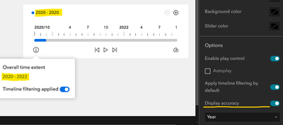

TonghuiMing
The new "Display accuracy" option added in the recent AGOL release provides you the ability to do so:
