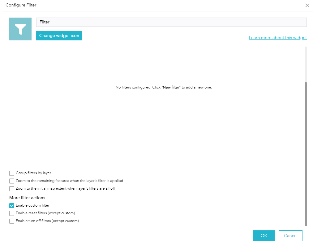

I am configuring an Experience Builder and I want to configure a filter widget and give the users the opportunity to create their own filter as we used to do in the Web Appbuilder. We used to just check the Enable custom filter box. is it possible to configure something like that in the Experience Builder?

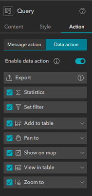

There isn't really a way to allow a user to make arbitrary queries in a Filter Widget, but the List, Table, and Query Widgets have the Set Filter Data Action that allows for the user to make their own query.
