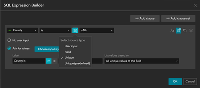

In ExB SQL builder, try using the predefined unique feature:
Or you will need to check the "Ask for values" option, otherwise, the SQL is indeed empty:

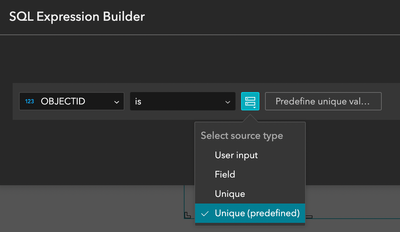

Thanks @TonghuiMing. I can't find the SQL Expression Builder pictured though. Where is that located?
BlakeMorrison
Good idea, but no dice. This works well for the filter widget, but doesn't perform as expected for the list widget.
I'm in the same position as @ZenMasterZeke - trying to display values in a list widget from distinct features only. Short of writing a python script to automate this, I'm absolutely stumped.

I'm looking in both the Filter widget and the Query widget. I don't see the "List values based on All unique values of this field" if I choose "Unique (predefined)" option but I do see it if I choose "Unique" from that dropdown.
So that seems to work. The Query widget gives more options for Actions so I'm going to use that.
