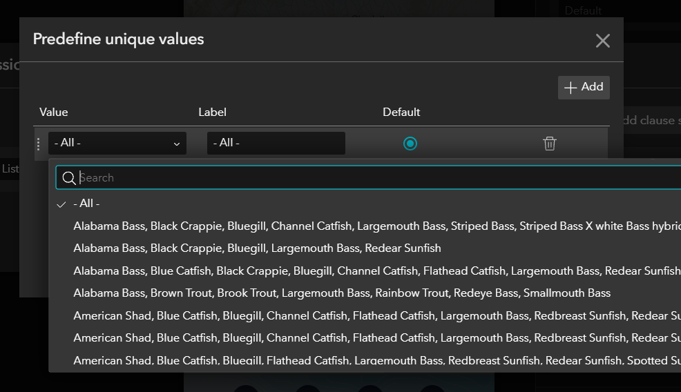

In Experience Builder filter widget, I would like to use 'Contains' to filter data. I have certain Text I'd like to provide filters for, but that Text is in a list within a single field.
I thought the Predefined Values would work, but it turns out I can't customize those predefined values (only the labels). I'd love to provide provide custom predefined values for the fitler and used Contains to find them.
For example, my field is a list of species like: Channel Catfish, Smallmouth Bass, Largemouth Bass, Bluegill
I want to provide the user a filter to look for all points with "Channel Catfish", etc. I could accomplish this easily if I could predefine my filter values for individual species and use Contains on that species field.
I think I've exhausted the possibilities to make try to make this work as described, but please let me know if I've missed something. So what I'm doing now is 34 individual filters with individual Contains clauses, which is cumbersome.
In this image, the Value option must be chosen from data in the field. I'd like to be able to set this filter list manually.

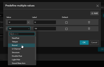

RichlandGIS
you can use the contains and do this with one contains clause to either let them filter by one species or multiple.  The predefine unique values will allow you to select only one at a time, the Predefine multiple values will let you check all that you want to filter by.
In the expression builder, push the predefine button as you did for the image above, and as you see, you can pick the values from the drop down list.  HOWEVER, you can type whatever you want in that field, it does not need to be in the list.
Will even do partial matches.  So, if you typed Red as one of your predefined values, the filter will show Redbreast Sunfish, Redear Sunfish, etc.
You could have a Bass that will select all bass, or Alabama Bass, etc.
Basically, though not intuitive, you can type whatever value you want and if it is in the field you are filtering on, it will find them.

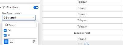

The filter above will find anything that contains the values (so, everything that has Tel or U in it):
