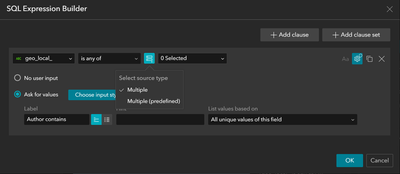

Hi, what about using "Author is any of selected", and choosing multiple for the source type, see my screenshot:
By using this configuration, users will be able to choose all unique values from the "author" field, users can choose either containing only one author value, two author values, or multiple author values.

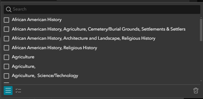

Unfortunately, I can't use this setting since I have multiple authors listed for some attributes that also exist as an author for a different attribute. See screenshot below.
What I'm hoping for is for all authors to be listed individually so that the user can select an author and all data that has that author listed will show up.
