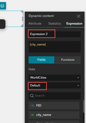

Hi @Lance_Charnes ,
Can you use an expression, instead of an attribute in the text widget?
You can customize the expression name so that it is displayed when there are no records in the data view.

ShengdiZhang
Hi @Lance_Charnes ,

Lance_Charnes
That worked. It's pretty non-obvious, though. Thanks!
