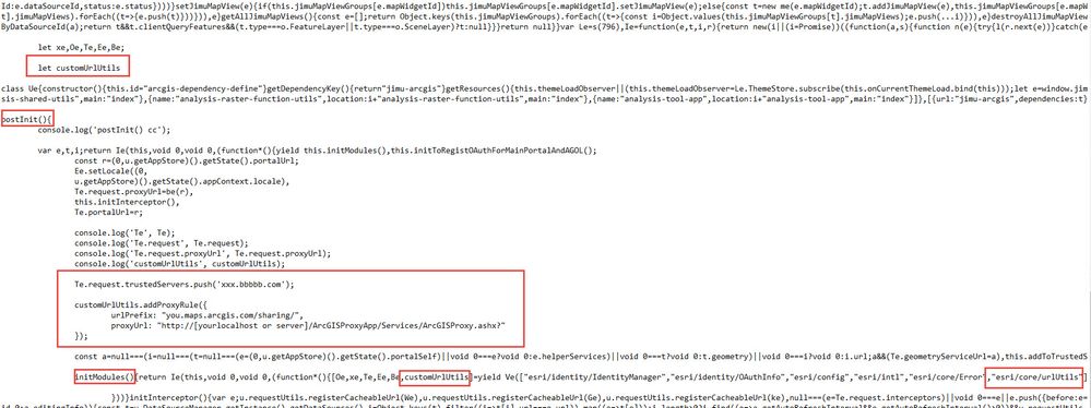

I was playing with two proof of concepts a while back:
a) Secured content hosted on AGOL - I could get that working by editing the obfusticated code in "~\cdn\1\jimu-arcgis\index.js"
There is for sure a lot of reasons not to do this, but it was just a test if one could get it working. DONT use this for a real world scenario.
b) Secured content hosted on a Portal instance that is protected by internal Active Directory credentials.
No luck here, I gave up. We are not upgrading a WAB application to ExpBuilder yet.

Gordon_Aberdeen
Love this hack.  Worked great for me with Developer.
There should be an open hook in the ExB Developer Edition for this kind of Proxy URL without having to re-invent the wheel.
HarryWang
How do you get file "~\cdn\1\jimu-arcgis\index.js"? I searched the experience builder developer, and also searched the download solutions. My "cdn\1\jimu-arcgis\index.js"  does not have anything for addProxyRule.  Thank you.
