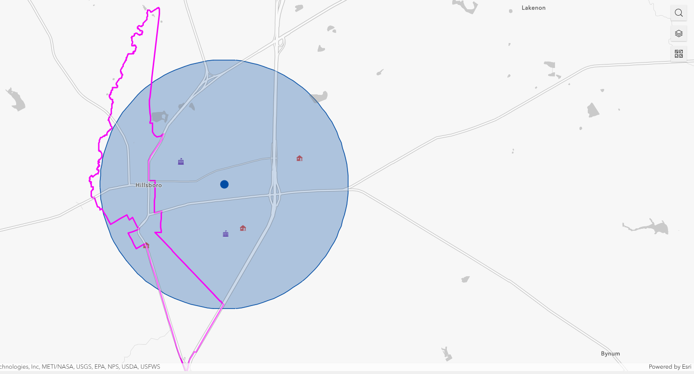

Hello,
I have been using the NearMe widget and it works great.  Once the distance is set and the zone produced I'd like to be able to simply toggle the shaded circle on and off.  Is there a way? I thought perhaps a custom toggle button but I don't what layer or id or whatever the proximity circle feature is stored as.  Perhaps someone has an innovative idea.

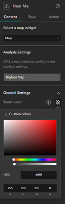

There isn't a built-in way for the user to toggle the search area. Nor is there a way for the designer to completely turn-off the circle. The closest option I have found is to set your Sketch Color to transparent white. You'll need to go to custom colors and set it to 255,255,255,0.
