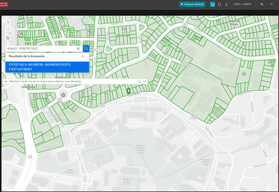

Hello, I would like to know if in Experience Builder you can do like in WebAppBuilder searches by coordinates using a WKID.
I used this syntax in the search widget in WAB: 465902, 1113823: 5367
I appreciate if you can help me see how to do this search or if this functionality is not yet in Experience Builder

ShengdiZhang
Hi @CarolinaAguilar ,
Thank you for pointing this out. ExB does not currently support this feature. We will look into this feature further to see if it can be enhanced.
Thanks,
Shengdi
ShengdiZhang
This issue is fixed in the latest AGOL update.
Regards,
Shengdi
CarolinaAguilar
Yes I confirm, thank you very much.
