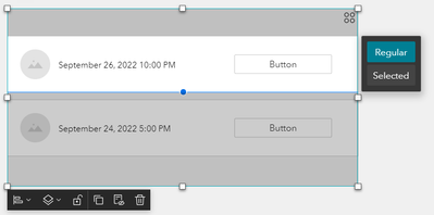

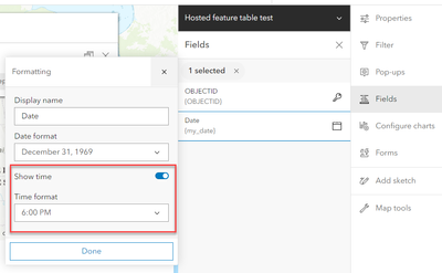

I added the hosted feature table to a map and configured fields to enable the Show time option:
And then the time info shows in my ExB app:
Which version of ExB are you using and would you mind sharing your application and data with me so I can take a look? My username is she10946.

I appreciate you taking a look. It turns out I was being a dummy and was choosing the wrong source for my table within Experience Builder. While I had previously set up the Show Time option within the web map as you suggested, I was using the hosted table directly when setting up the 'Connect to Data' settings, rather than choosing the appropriate web map that had the field configurations. I probably wouldn't have ever noticed though if I hadn't been putting together screenshots to show the issue after your reply, so thanks for the help!
